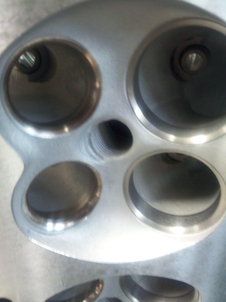

Our heads are CNC'd which means each head is exactly the same. You cannot do this by hand. Our heads flow better than the others. Our heads have CNC'd chambers so each cylinder volume is exactly the same. This again, cannot be done by hand.
The reason ours is more expensive is: We use better parts, replace the valve seats, we replace the guides, our valve seats are ground by a Serdi Machine (best there is) All our heads come STANDARD with oversized black nitrided valves, 1.8mm larger intake, 2.3mm exhaust. Beehive racing springs with titanium retainers. Single groove keepers will NOT drop valves at high rpm. (these are good to 10,000 rpms) Since the CNC machine cuts the chambers it also relieves the valve area for better flow. There is no better head out there. I guarantee it. Once you put it on your car you will understand what I am talking about. You can see it in the dyno's that our cars make more power on less boost. That shows you the head is more efficient than the others. If you are on our forum there are video's you can watch of customer cars over the Thumper head (driven by thumper himself) to see the massive differences. Our head is $2150 with ALL of these parts as standard , not some cheap price then add it all up and its more expensive than mine and makes less hp. Core charge is $400. I have 7 heads at the CNC shop now and should be ready to ship sometime next week.

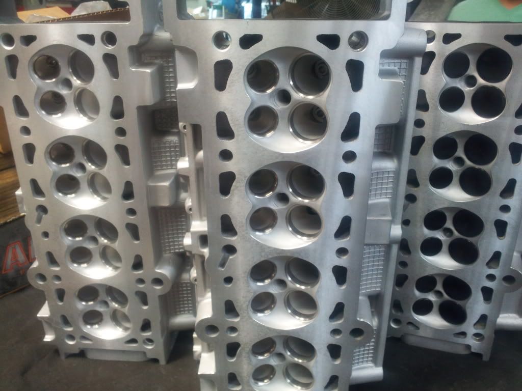

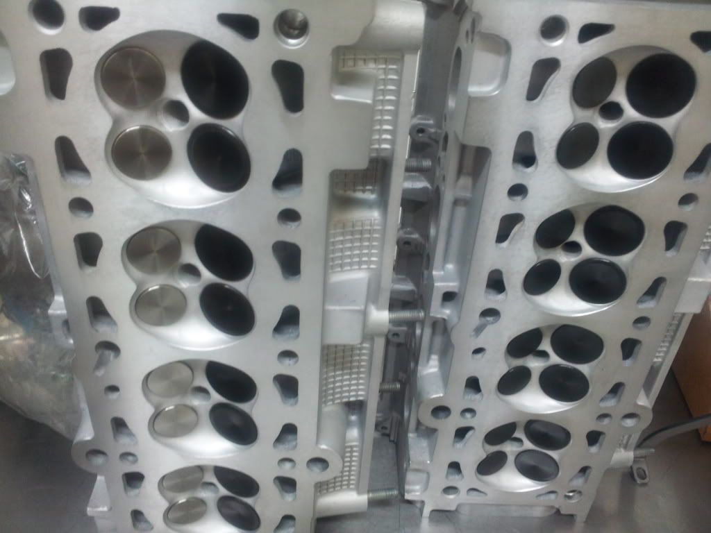

What are the main differences? I do the Ported Head to the application of the driver. This is why I offer 4 different designs. The r50 and the lightly modded r53 , doesnt NEED to have a Hugh runner and Valves for the daily commute, or saturday track outing. ( TPR1) With more mods and the ability to use MORE flow and rpm levels, I increase the port work and bump up the quality of the valves and valve train. Again the need for the largest inst needed (TPR2 ). And finally the driver has a highly modified engine and tracks more than the street, but STILL wants torque and reliability for street and traffic. I do the largest runners and vales size the TPR2r.
I wish to build for the street and aggressive driver, that will hit the track a few times and like the ability to run the county lanes and the city. depending on the application and the desires of the owner, MPG can increase, HP and torque will increase, with out sacrificing the reliability of the cylinder head.
> Why is your head cheaper? My Cylinder Head pricing is more for the average enthusiast that isnt on a 'Racing" budget, and yet wants all the performance he can afford. I do all the wok myself, in my shop. Every Head I have sold is totally made and ported by myself. I dont become a middle man where a different shop will do the work, and I just sell their product to the customer.
> Can i run your head with my current set-up or do i need more mods? The cylinder Head is a key to performance.. it is NOT THE Performance. Good example of going to a full on BIG valve Racing Head and THEN have to build your engine to USE the that head. Again the reason I do 4 types. Get it right the first time. The TPR2 and the TPR2r will support 350-400 HP with ease. ( see attached on Heads)

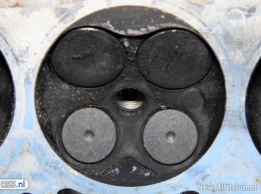

Ik heb eindelijk de kop eraf maar maak me zorgen om de verbrande olie op de zuigers en kop.
Heb expres gewacht met het bestellen van de RMW kop omdat ik eerst wilde weten of alles nog goed zat.
Nu was mijn olieverbruik altijd heel erg hoog en de achterkant van het blok zat ook goed onder de olie vanaf de kop naar beneden.
Op een gegeven moment lag ook de koppakking eruit.
Daardoor kwam er olie bij mijn kvs en uiteindelijk ook heel klein beetje kvs bij de olie.
Wat denken jullie?
Lekt dit blok eerder via kleppen of zuigers?
En doe ik er slim aan om hier een RMW kop op te zetten?
Berichten: 13494
06 jan 2013, 16:44
Roet op de kleppen en in de kamer is heel normaal. Dit gebeurd al bij het uitzetten van de auto en brand weer weg op de Autobahn. Zie hier mijn kleppen na loshalen enkele jaren geleden.
Olieverbruik is niet op te lossen met nieuwe kleppen als je olieverbruik hebt.
Voor olieverbruik moeten er nieuwe overmaat zuigerveren en cilinders uithonen op de overmaat en dan auto opnieuw inrijden.
Als je kvs bij je olie hebt gehad de olie natuurlijk wel verversen.
Als je overmatig roet op de achterkant van je auto hebt kan je verbranding te rijk staan. Een beetje kan geen kwaad.
