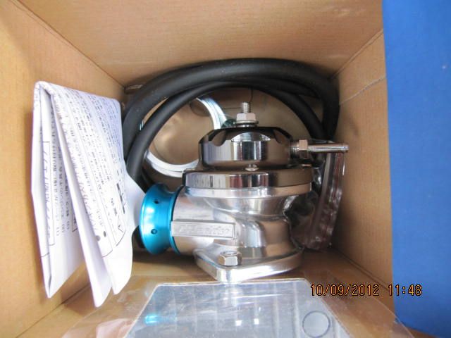

Second quote,to keep you all busy lol.
Oh btw,hierbij is 1,5 psi extra verkregen met fmic,waar dat je normaal rond 1,5 psi verliest...
-- The purple thing is a Greddy Blow Off Valve - the thing that goes phhhsssstt when a turbo car goes by you . I've just used the vent that blows off to recirculate back into the sc inlet pipe when off throttle as other wise AF mix will be wrong as the Map sensor has already accounted for the air - something like that anyhow . I hated the stock BPV with 100% hatred as it really is shit IMO so this shuts really tight and keeps boost up . For my needs I hope it works as I can sacrifice smoothness a bit It has an adjuster if it's too loose/tight
